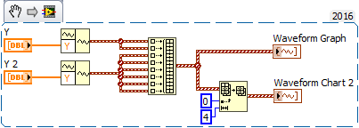

4channel.PNGFor (4) channels this works like a champ.  IF i add channels, to the DAQ and to the bundle (sorry i said unbundle earlier) it doesn't like that.

Show your broken code.
I get single point for each channel form DAQ? Or array of points (waveform)?

why youuse waveform for single element?

Why not?
on chart you'll see last point only, without history.
And why you want draw clester of WF, not array if WF?
Take subarray of your data and send it to chart
