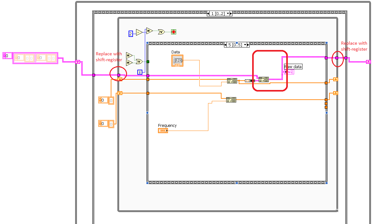

Ah ok.  Try the connection I am showing in attached image (since I don't have your code, I have edited your image- might have been easier to edit the code):
New Controls & Indicators made using vector graphics & animations? Click below for Pebbles UI
I have tried what you suggest, but it does not do what I want. I have also added the vi of the test file I have made. That should help.
