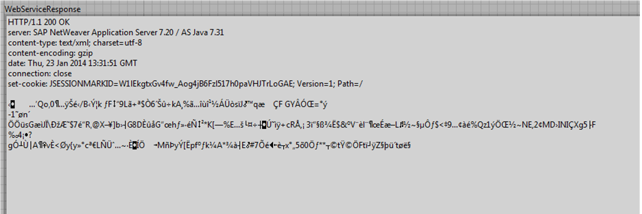

I'm hoping someone with some SOAP experience could help me find a solution as to why the XML data coming back from a Web Service (SAP manufacturing) is unreadable.
In the file attached is the response from the Web Service, and as you can see in the header the request is OK. (request was to move a serialized PCB from a "queue" to "work"). Request is successful (I verify this manually by logging into SAP web service directly and verifying), but in addition data on that PCB is to be returned (board stock code, etc..).
My request and response with returned XML data works fine in SoapUI.
Any help would be appreciated.

Well, I took a chance and opened the docx file. You placed a screen shot of the text output (WebService Response)
The first thing I see is that the HTTP header shows that the content encoding is gzip.
You will have to uncompress the data, or request the data in a way that returns uncompressed XML.
I've added the picture below for others...
You could extract the content portion and use this to deflate the contents...
https://decibel.ni.com/content/docs/DOC-7200

Thanks for the reply, but maybe I didn't describe or show the issue correctly.
Attached is XML request and response using Soap UI and the response using Labview2013. Just a bunch of garbage characters in the labview response which I cannot show in a text editor such as notepad so I had to take a snapshot of my front panel string indicator to show the garbage characters from the web service.
I could also send RAW header request and response if it will help.

JonnyR - Please use the uncompress function that I included on the same link earlier. You will need to remove the HTML header portion of the string. If you don't, the uncompress will interpret the header as compressed data and you will get jumbled data as an output.

Thanks Phillip. Your solution worked great. After I parsed the header, and ran the compressed data through the .dotNet Decompress.vi, the data was now readable.
