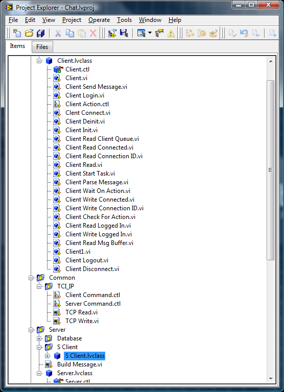

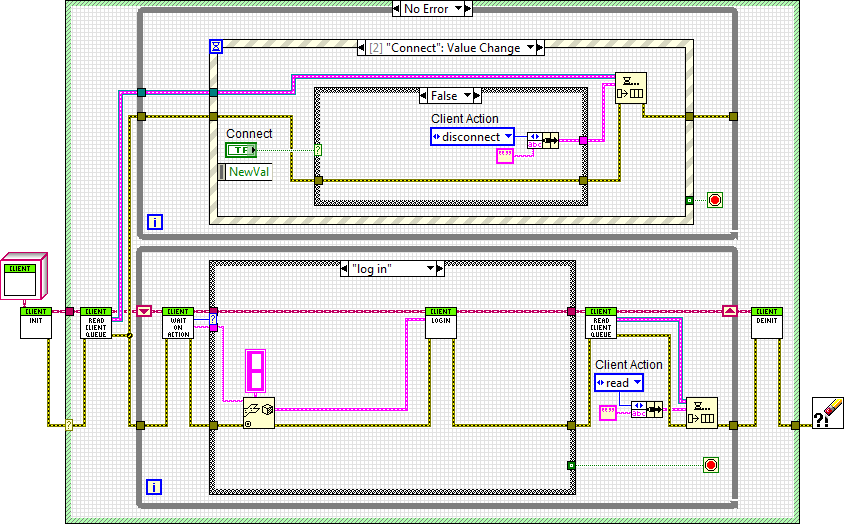

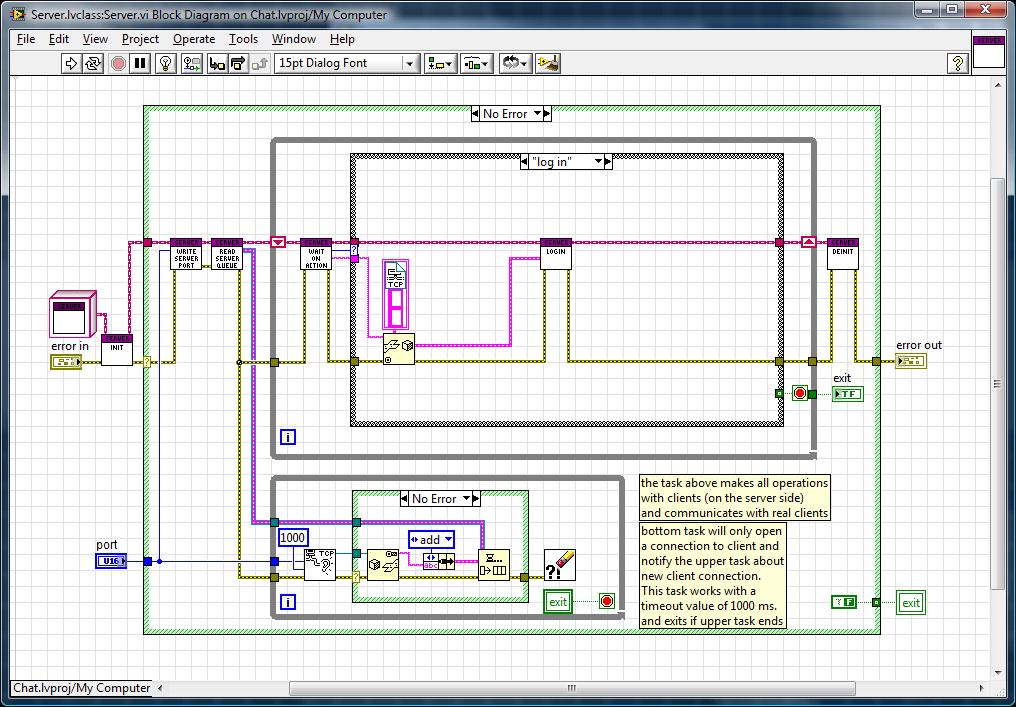

Hi all! I started a new project - "Chat". It's all programmed with LVOOP and works fine for now. If anybody is interested in this project, so notify me here. Thank you, eg

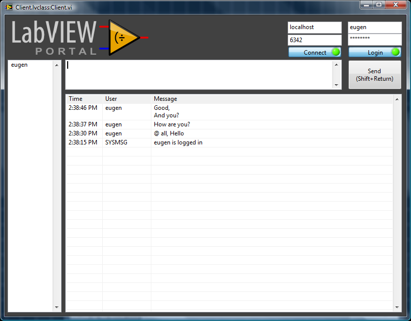

Hello!
If anybody can test the Chat, would you please download the Client-Project and connect to my local IP-Adress:
92.193.60.151
I started the Chat-Server for this weekend. If you can and want to give some feedback, you can post here or discuss it here (no password required).
