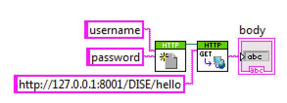

As described in a previous post, I'm trying to develop a thin client in python on a Raspberry PI that gets data from a Web Services program. I wrote a simple "Hello World" vi that requires authorization. If I access the URL from IE, Safari, etc, it gives me the Silverlight login screen, and then it works. If I write a simple client using the HTTP Get vi, it works. If I access the URL from Python:

I poked around a bit more. First, I misspoke; the response was 403 (Forbidden), not 404 (Not found). Having said this, Darin K. is correct  in his recollection of the exchange.
Here is my setup to attack the problem:
Server machine running Labview web service as a standalone server. There is a user "user" with password "password".
Client machine has LV 2014 Professional. NI Web Server is disabled. Proxycap is configured to forward all traffic from Labview to port 8080 on localhost. OWASP ZAP is listenng on that port. A man in the middle attack.
On the client, I have the simple VI (see previous post) that configures OpenHandle with the user credentials. It then issues a get to the server. Here is the (editted) traffic:
