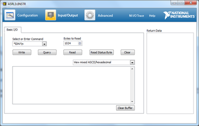

Hi Oesen.
After you have configured your connection, you can use the Input/Output tab to send and receive commands:
On page 55 in the manual, you can see which commands your weight supports.
If you have an older version of NI-VISA the test panel might look different. This KnowledgeBase shows a screenshot of an older version:
https://knowledge.ni.com/KnowledgeArticleDetails?id=kA03q000000YILfCAO&l=en-US
