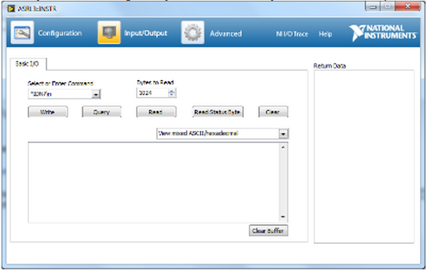

Yes, but as far as i know, i'm going to write my commands, and read it after in the test panel, but i always get that error:
"Timeout expired before operation completed" during reading process

And as far as we know, you could be writing gibberish. Explain exactly what you are writing. Better yet, attach an image.

Hello. Sorry, i was inactive for some days. But im writing those commands from the manual, and reading it after

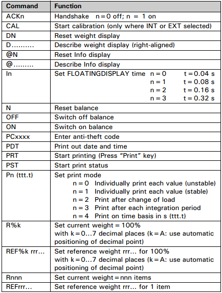

That image is just about unreadable but it looks like your command string is *IDN?. Your list of commands does not show *IDN? so why would you want to send that?

Yes.. Im sending it as *IDN. What should i else send ?.. Sorry my serial port cable is in workplace, so i can't open the test panel right now

You have to send commands that are supported by the instrument! You can only send what is listed in that table. You just can't make things up and expect a response. You also cannot do a read when the instrument does not send anything back. You also have to terminate each command with a \r\n (CR\LF).

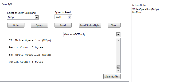

And im writing the command "DN" which resets the weight display:
As shown in the picture below:
Anything wrong with that procedure ?
