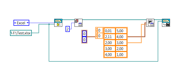

I'm trying to wrap my head around a weird problem:
I write a 2D array of double (decimal delimiter is a comma, so 1/100 is 0,01) into an Excel Workbook. I created this file "Test.xlsx" by hand and did not change anything regarding formatting of the cells.
But what I get in Excel is this:
Why
1. is cell A1 different in formatting from all other cells (format and justification)
2. are the values of those other cells wrong? There seems to be a problem with the decimal delimiter.

Thanks for your reply.
But regardless of how I format the cells in Excel, the outcome is still wrong.
From 0.01 (1/100) in LabView it goes to 1000 in Excel in all cells but A1.

zou>> I do not think so, I think it is yet another situation where NI has not thought about countries that do not have the same decimal separator as the US.
joptimus>> The solution is to feed the array through "Number to Fractional String" with the setting "use system decimal point" = false and then feed it to Excel Easy Table.
Then it will work.

Perfect, you saved my day! Thank you!
One follow up question remains though:
Can I somehow write an 1D array into existing Excel cells? The "easy table" VI seems to accept only 2D arrays.
(3,628 Views)
You can simply feed the 1D array into "Build array", then it will become a 2D array.
