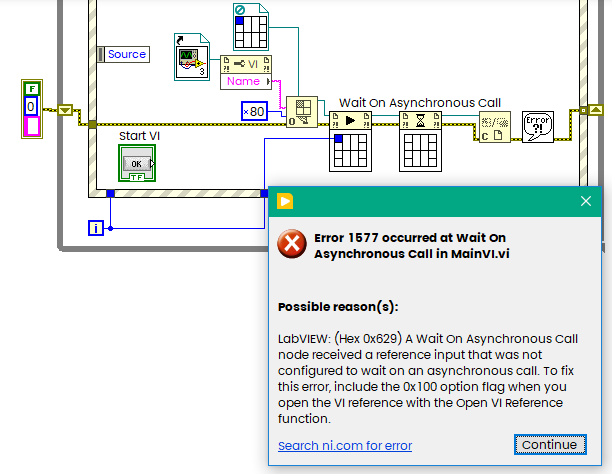

Just curious how did you get it running with 0x80? If you using Wait On Async Call, then 0x100 is required:
Otherwise error 1577 raised:

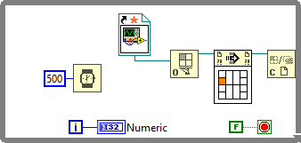

Run this and activate a (vi) menu:
This is pretty important. If you activate a menu (any kind, VI or context), your state machine will hang on Open VI Reference.
So you might want to open VI references at initialization. Easier said then done, as you'd need to know in advance how many references you need.

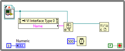

HOWEVER, and this is GREAT news, LV24 doesn't wait for the root loop:
This does wait for a free root loop:
This doesn't:

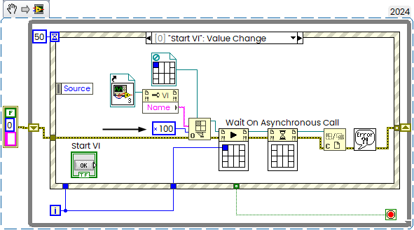

There's actually a very simple explanation: I didn't wire up the error coming from the Wait On Asynchronous.
So here's an updated snippet.

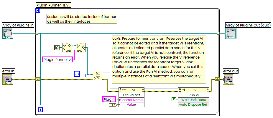

Its a great feature, which is extremely useful in PlugIns-based architecture, helps to avoid crazy structures like this:
This is how I realized "call & Forget" with reenterant helper in LabVIEW 8 in the past.
