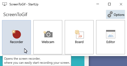

Using ScreenToGif (https://www.screentogif.com😞
I use ScreenToGif too. It's very easy to use.
Nice tool! I've always used OBS to do that, what a pain for such a simple task 😅.
