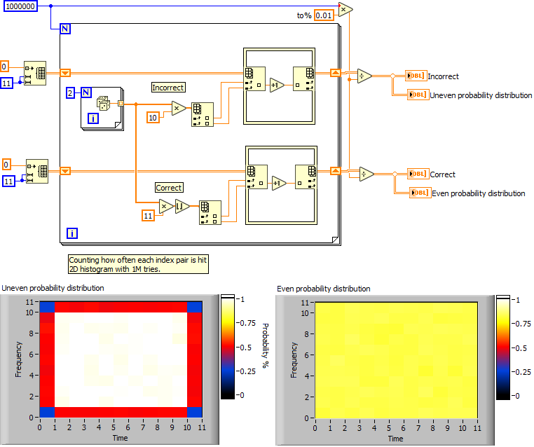

@alhebu wrote:
3. I don´t understand... could you explain why not ocurr at the same probability?
Because you are rounding to the nearest index, so e.g. 0 occurs for values between 0 and 0.5, while 1 occurs for values between 0.5 and 1.5, a range twice as wide! Correct is to multiply by 11 and round down towards the next lowest integer. Now 0 occurs for values 0..1, 1 occurs for values 1..2, etc. All ranges have the same width! Note that the random number is never exactly 0 or 1, so you don't need to worry about rare edge effects.
Here's a quick demo. Note that since we are in 2D, edges get half and corners only a quarter with your code. You'll never get a job working for a Vegas Casino if your random numbers are biased. 😄
