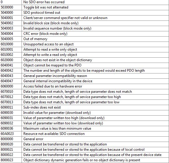

Here are the codes the NI master can decode using the API decode VI. Values are in Hex.
All codes not available might be defined with the device documentation that returns it.
DirkW
