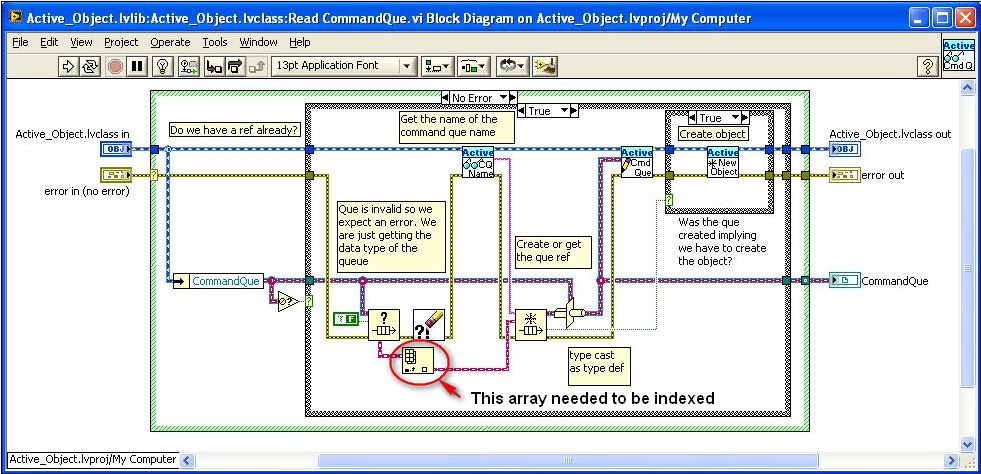

What does "refnum not valid in this context" mean andwhat are the ground rules for when a queue refernce is valid or not?
Ben already knows this, but for others following the thread, the reference became invalid because an array of references were being typecast instead of a scalar reference. The fix shown below is implemented with an index array.  NI does not recommend typecasting references unless you are very familiar with the underlying data, as it is easy to make mistakes.
As far as contexts are concerned, I believe the specified context was generic in that LabVIEW said 'I can't find this refnum, therefore it isn't valid in this context' since if lv cannot find an active reference of that type, we have to keep the possibility open that it may be valid in another context, aka project. TST was spot on for the definition of a context...the most common context is simply a project. I will try and dig to get a more 'official' definition and maybe some more examples related to lvoop; our next meeting with our lv experts is on Wednesday. I will post if I find more useful information.

That reply only prompts more question you know!
Yes that index array stopped my crashing but...
1) What is the "right way" to create queue ref that is linked to a type-def that does not use the Type Cast?
2) If you look at the Probe #[15] in my orignal post, you will see that the "CommandQue" is NOT showing invalid, it is the response queue that was invalid.
