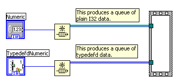

Coercion dots/typedefs/queues
Short story: I would not in general typedef a queue. I would frequently typedef (or make a LV class) for the data inside the queue. A typedef is for a data type you expect to need to change or that you need to somehow differentiate from other types in the vicinity. It is pretty rare that you decide to swap your queue out for a notifier, and I cannot think of any other data type that you would ever even possibly swap it out for, so the "expect to change" reason doesn't apply. You might, in rare cases, have multiple queues that all carry the same underlying data and you want to be careful not to wire a refnum wire of one queue to a terminal of the other queue, so you make a typedef of the queue so that you get a coercion dot. That's reasonable, so it might happen, but rare, so I wouldn't generally do it.
One of the reasons that I wouldn't generally do it is that it requires either a coercion dot or the use of the Typecast node...
Ben wrote:
1) What is the "right way" to create queue ref that is linked to a type-def that does not use the Type Cast?
This may be too basic an intro for Ben, but I figure I'll be thorough.
Here are all the different types of controls that we're talking about in this thread:
It is easy to create queues of type C and 😧
If you create controls/indicators off of the top two wires, you'll get controls of type C and D respectively.

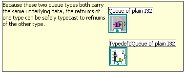

Ben wants to know how to create E and F. You can change C into E and D into F using the typecast node or coercion dots...
Like this...

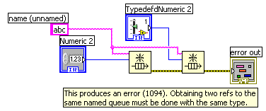

For the record, you shouldn't cast queues whose underlying types are different. When in doubt, try using the Obtain Queue primitive to test the types:
If the second Obtain returns an error, don't try casting refnums of those types.  It might work. Then again... it might fail spectacularly or, worse, fail in a subtly wrong way.
tst wrote:
Presumably you wouldn't get coercion dots if you didn't make the control a typedef, but instead allowed LV to take care of it by only having the queue data a typedef.
I can't say whether this is good practice, since there's no official documentation which says that a queue ref will adapt to the typedef that's inside it, but it seems to be a reasonable thing to expect and you know how to get NI not to drop support for it.
The preservation of the underlying typedef type is a designed feature of the queues. It's been that way since, oh, I don't know, a long time ago.
