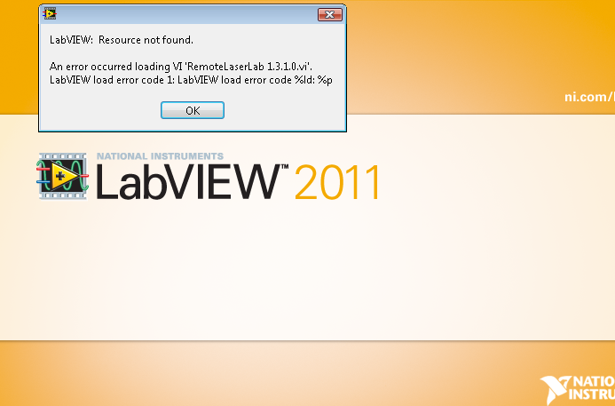

Resource not found problem
After more than 10 years later 🙂 I have the same problem. How to open such VI?

Why don't you attach the VI? Where did it come from? Is this the first time you tried to open it or is this an error you just started getting?
(3,625 Views)
I saved this VI (normally, without any notifications). And tried to open a few minutes later. After I failed to open it, I tried to do it on another computer - but with the same result.
It seems I can't attach this VI here because "The attachment file size is too large. The maximum file size is: 5,120,000 bytes", and mine is a bit more than 6 mb...

That is huge for a VI. Sounds like it got corrupted. Restore from a backup.
(3,611 Views)
Yeah, of course I did, but still. Restoring from the backup means that a few hours of intensive coding was wasted... So, restoring from the backup is definitely a solution but it doesn't solve the problem itself - why LabVIEW (2011) corrupted VI and didn't save it properly?
