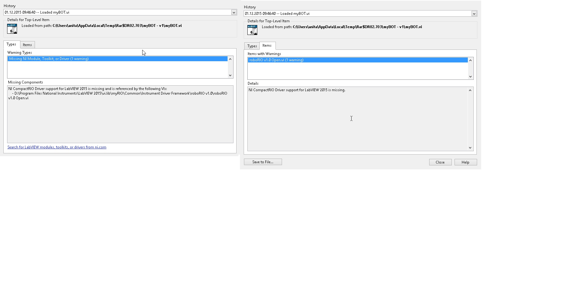

What does this message mean ?ni compactrio driver support for labview 2015 is missing
I get this message ni compactrio driver support for labview 2015 is missing. Is very fustrating. I installed all the cd that came along my rio, i also have something called toolkit installed allready. Its when i start a program downloaded from net mybot ( segway program) i get this message. Has anyone the same problem? solutionfaulti.jpg

Did you install the drivers also?
You need to have the NI-RIO driver installed. You should find it on the DVD's or you can download the driver on the NI site.

Please go into NI-MAX and verify that you have installed all the drivers, and what version you have installed.

Hi student,
what did you install?
"something called toolkit" and "some driver dvd" isn't enough information fur us to tell you what's wrong! Please check, what software you did install (MAX -> Software section).
You need to install drivers after you did install a new LabVIEW version. And you need to install drivers for each LabVIEW version you want to use…

If you installed LabVIEW 2015, you need the latest cRIO and DAQmx drivers.  Any driver set from 2013 will not be compatible with LabVIEW 2015.

Thanks, I opend max now and took a picture of what drivers that is installed. see attatchment / also a picture of the DVD i installed.

Did you install the cRIO drivers AFTER installing LabVIEW?  I would try reinstalling the drivers.

yes, I installed the drivers last.
Thanks! I will try that reinstall

Thanks! looks like it helped for the error I had didn show up 🙂
No I got a new one  363013 message attatchment.
