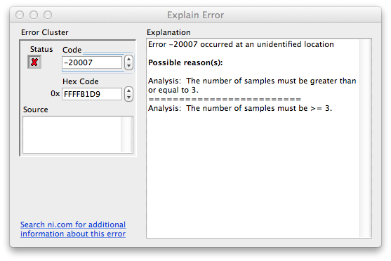

Explain Error works fine for me. You need to type in the number.
 The explanation points out that 3 or more samples are required. You only have two.

Well that was easy. I must have typed in the wrong number somehow.
