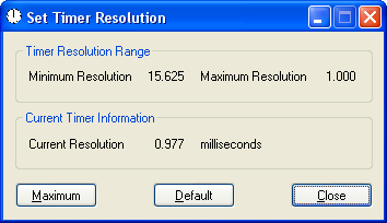

Apparently the Windows timer can be set by API calls. See: http://www.lucashale.com/timer-resolution/. Here's a screen shot of his TimerResolution.exe on a Windows 7 PC:

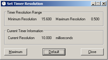

Win7 Set Timer Resolution.pngHere it is on my Windows XP PC after I set it to "Maximum" (initially it was 15.625 mS): Win XP Timer Resolution.PNG
Notice that it sets the Maximum to less than 1 mS, which is supposed to be the max, so there are some bugs. Plus the Default button does not reset it in XP, but does work on Windows 7 or 8. (I know this is not the place to "debug" non-LabVIEW applications!)
I'll bet LabVIEW sets it, too. The only caveat, as I said, is it looks like another application can change it, since the hardware timer is a "global" timer. I have not seen this issue in my LabVIEW applications, have you?
