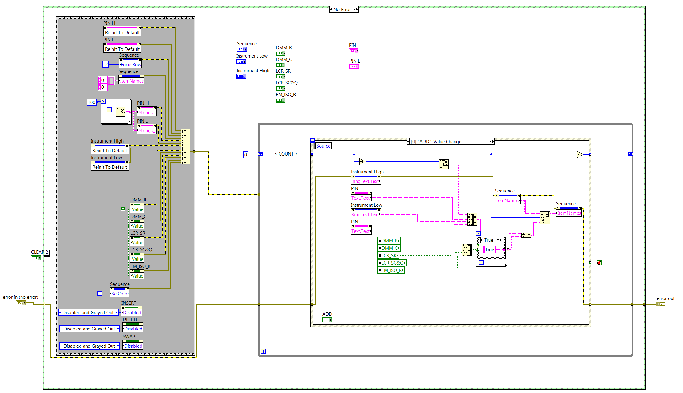

What is the best way/place to initialize everyting in my VI?
Ok LabVIEW Pros.... I am new to LabVIEW and am creating my first (Semi-complex) work station powered by LabVIEW. In an attempt to form the best LabVIEW habits possible I am in need of help. With GUIs, there are always several variables and controls/indicators that need to be initiailized. What is the best method for doing so? This works perfectly but just looks Ugly to me.... Would it be better to throw this all in a subVI or at that point do I have to worry about all of the references etc...? Ideas and best practice advice is much needed/appreciated. See example below...
Thanks Guys!
Kellen

If there are things that can change during the program and you want to remember them when the program closes, then you can read from and save to a config file. You can use local variables to set the value of things, no need to use the "value" property node.
For manipulating control properties it can be helpful to create a cluster of all of the control references and store them in an Action Engine
for later use.
You probably don't need to collect the errors of all the property nodes, I don't think much can go wrong there. Sometimes I initialize things in a flat sequence as you have done, or if I have some kind of a state machine I will do it in an "Init UI" state, which saves a lot of space.

It's hard to judge an image, but things don't look that great. It would be more useful if you could attach the actual VI and also explain how it is used and what it is supposed to do.
  • From the outer case structure, this seems to be a subVI. Is it? In this case, controls typically receive values from the calling VI via connectors.
  • Why are none of your controls connected to the code?
  • It is typically not a good idea to hide an event structure inside a case of a case structure, so things seems inside-out.
Message 3 of 12
(8,848 Views)
I was just using the error out's to try and GUARANTEE that these things are executed. For some reason I thought this was necessary, but what your are tellin me is if they are in a flat sequence then I don't really need to connect the error wires at all and they will all get executed for sure before entereing the while loop?

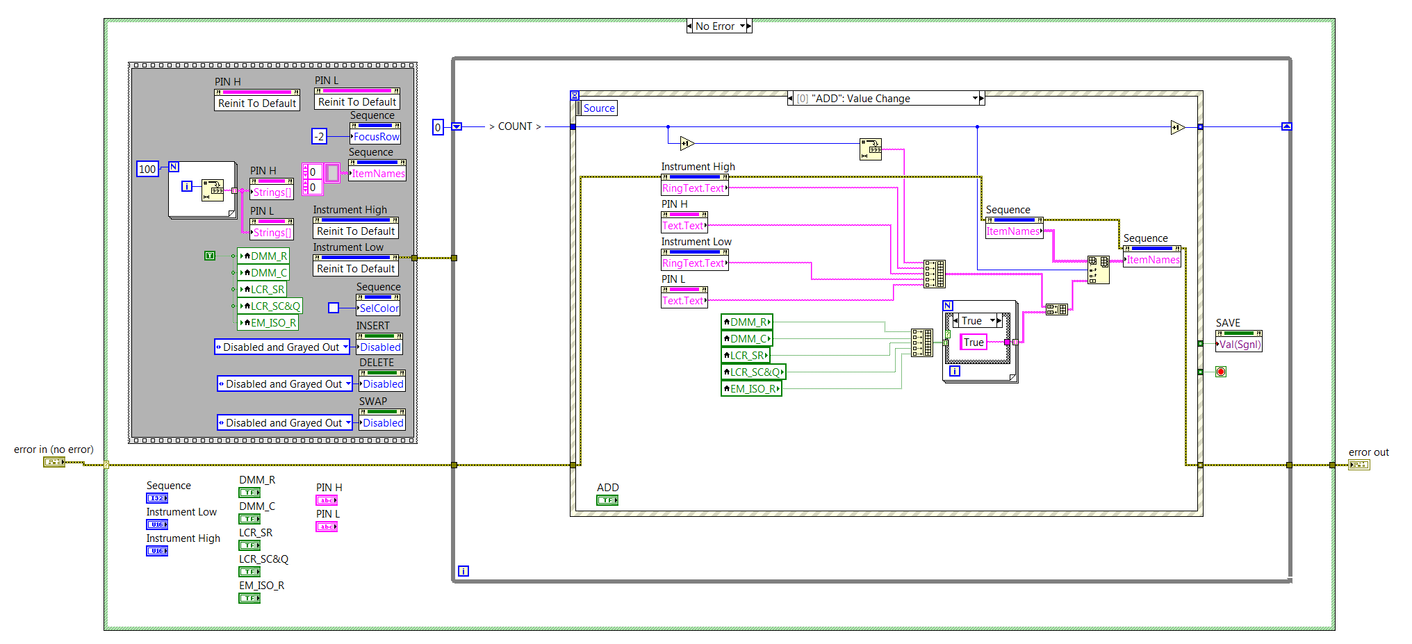

altenback,
This is a subVI, but it doesn't receive any inputs from the calling VI, just allows the user to pop up this SubVI to create a measurement sequence file. The only thing returned is the Multi-Column Listbox values. This subVI allows the users to Edit, Swap, and Delete rows from the sequence being generated, as well as save and load the sequences. The idea was to give the use some tool to generate these measurement sequences that will be used with insturmentation and a switch matrix. I haven't attached an actual VI before so hopefully this works.

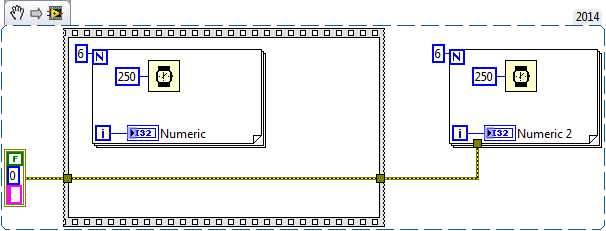

Yes, you don't have to merge all the error clusters, just running one wire out to the while loop is good enough, as you have done. In this snippet, the For Loop on the right has to wait for the one on the left to finish before it executes. If you disconnect the error terminal though, they will both execute at the same time.
