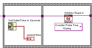

With counter tasks in DAQmx, however, your best bet would be to use the 'Get Date/Time in Seconds' VI to obtain the absolute time. You can set this up so that the absolute time value is obtained right before the DAQmx read function is called, as shown below:

Thank you for the reply. I am collecting analog waveforms without any problem. I am using a method similar to what you show for creating an initial timestamp on the engine speed measurement. This should be accurate enough since this signal is updating every .0005 seconds. I am not sure this same method will work for the index pulse since it is only being updated every .1 seconds. The DAQmx read function is in a for loop which also runs every .1 seconds. The time at which the index pulse is read may lag up to .099 seconds after the pulse occurred. I think the accuracy of the measurement would depend on the phase shift between the pulse and the DAQmx read. Let me know if I am missing something here.
I think a better solution for me might be to sample the analog data based on the timing of the counter for the flywheel teeth. Can I use the implicit timing of the flywheel teeth counter as the source for the analog counter? I realize I would no longer have waveform data but I could create an XY graph instead. I hope I explained this clearly. Let me know if you have any questions.
