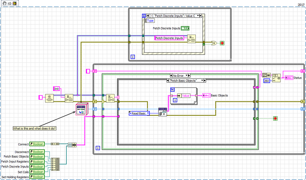

What is this in the Modbus example
I am new to Modbus and downloaded the NI Modbus VI's
Looking at their example there is a VI who's icon looks like a cube, but this VI is no where to be found on the Master or Slave Modbus API
Undocumented example code is just as bad if not worse than no example code.

This is an object: https://www.ni.com/docs/en-US/bundle/labview/page/classes-and-objects.html
Create it as constant from wire/terminal.
