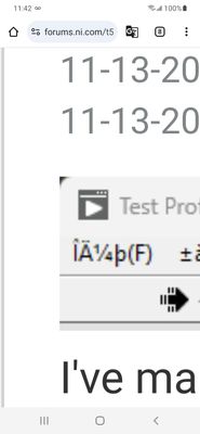

I've made a thousand applications and have never seen this before. Why is my menu garbled? It should be in English.

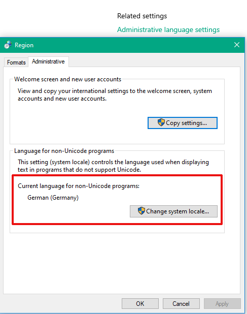

The very first thing needs to be checked is the language for non-unicode progs, should be English for your case:
This change will take effect after restart (or logoff/logon).

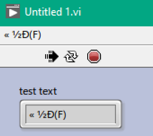

Got this reproduced:
It is Simplified Chinese (and 32-bit LabVIEW, by the way)

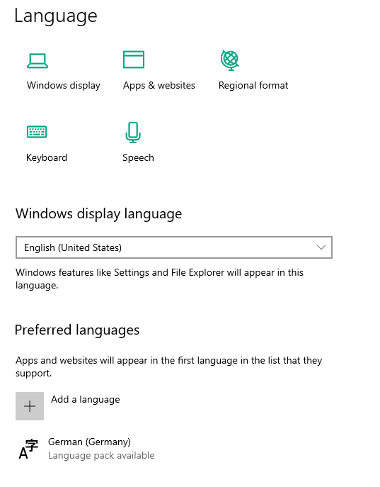

Check preferred language setting here:
(For me default menu appeared in German).
