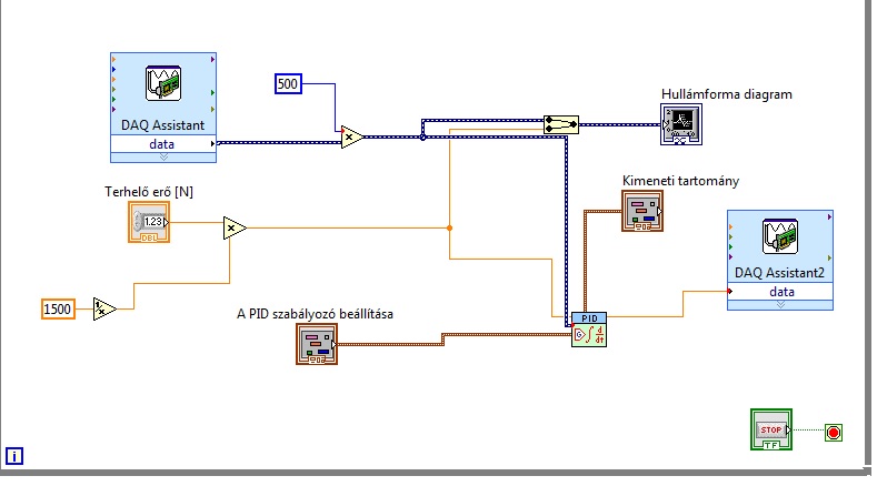

What is this red dot? How can i solve it?
I can not run it, because there are red dots. I know, it means the signal from DAQ  and the constans 500 are not same type, but i have to Multiply the analog voltage signal from daq. How can I solve it, how can i multiply the analog signal from daq (20mV) with 500? Or is there any option to convert them?

The "red dot" is called a Coercion Dot.  As for how to fix it, by the look of your program you are wanting to acquire 1 sample at a time.  Configure your DAQ Assistant accordingly.  (And then stop using DAQ assistant completely - right click on and generate daqMX code... but that is a separate issue)

You actually have three coercion dots (at the multiply, at the PID function. and at the rightmost DAQ function).
There is nothing to "solve" because the code works correctly, right? A coercion dot does not break code. Just ignore it.

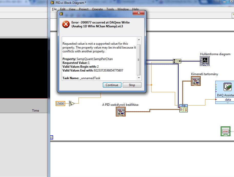

Thanks, but does not work. this is the message:

How is the express VI on the right configured? (Impossible to tell from the picture!)

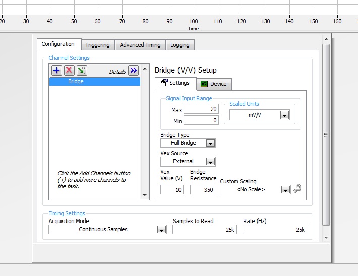

But there is an other problem. I dont know how can i set up the bridge in daq. the load cell: 10 V supply voltage, 2mv/V sensitivity,
So if the load cell receive maximum force, then it provide 20mv signal. But the output signal is not in range  0 - 0,002 V. The signal is 0-24 something...
What is the problem?

The error is being generated by your DAQmx write, not read.  How is your "DAQ Assistant 2" configured?

I attached. So i don not undersant why show the indicator these values, if i set up  the bridge,

I would change your DAQ Assistant 1 to be continuous samples, 1 sample per second.  Then change the dynamic data type to a scaler numeric.  Part of your problem is that you are taking 25,000 samples, but only using 1.
