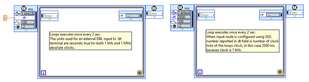

I thought I'd found the solution but I was premature! It turns out the answer is more subtle and my intuition was right. The terminal data type change to DBL accompanies a change in the unit from the base clock unit to seconds. However if the input node is configured with the GUI, then the number reported in the dt terminal is still the number of ticks of the clocks base unit (period). Both loops below run at 2 sec loop rates, but the left is configured with a DBL input of 2 at the dt terminal, while the other was configured using the GUI and the 'dt' value reports 2000 ms (both use 1 kHz absolute clock).

This smells like a bug to me.
The dialog box is 2000 ms (and the terminal saying dT is in blue but the triangle is orange).  While you right click on it and create a constant, which is orange, you need to enter 2 to give the same 2000 msec.
