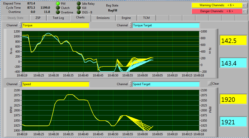

OK, I have a once-in-a-blue-moon bug to track down, having to do with a data file that's incorrectly written at the end of a test.
During one of my trial runs, the charts on the front panel started behaving really wonky, as shown in the pic.
I feed each chart a bundle of two DBLs, every 0.5 sec.
This is a CHART, mind you, not an X-Y graph, so this cannot happen.  But there it is.
The chart would stall for 10-20 seconds at a time, then catch up.  The fact that it caught up says that the data did get fed to it.
The CPU usage went from the usual 3-4% up to 60%  or more during this one test.
The file written was OK in this case, so I'm not certain this has anything to do with that, but I'm not certain it doesn't, either.
I've run hundreds of tests and I cannot reproduce the incorrect data file, but perhaps this is indicative of a similar problem.
Anybody seen this, or is it just yet another 8.6.1 bug ?

If I click on one of the CHANNEL selectors, a menu appears.
As long as that menu is up (covering a portion of the chart), the chart behaves perfectly, and CPU usage is 5-6%.
As soon as I drop the menu, the chart starts being erratic, and CPU jumps to 60+%.

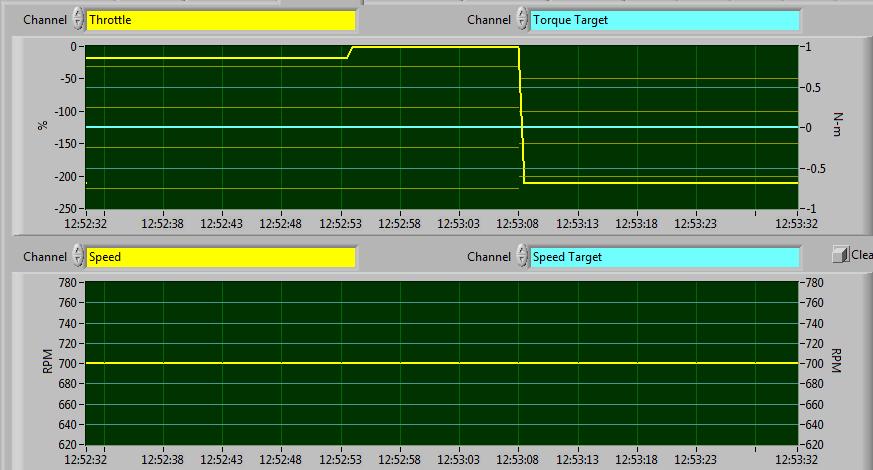

We have a DIFFERENT problem in a built app:  When I change channels, the value takes a jump (expected). the scale changes (expected).
But the gridlines cannot change in the middle of the chart - that's just ridiculous:
