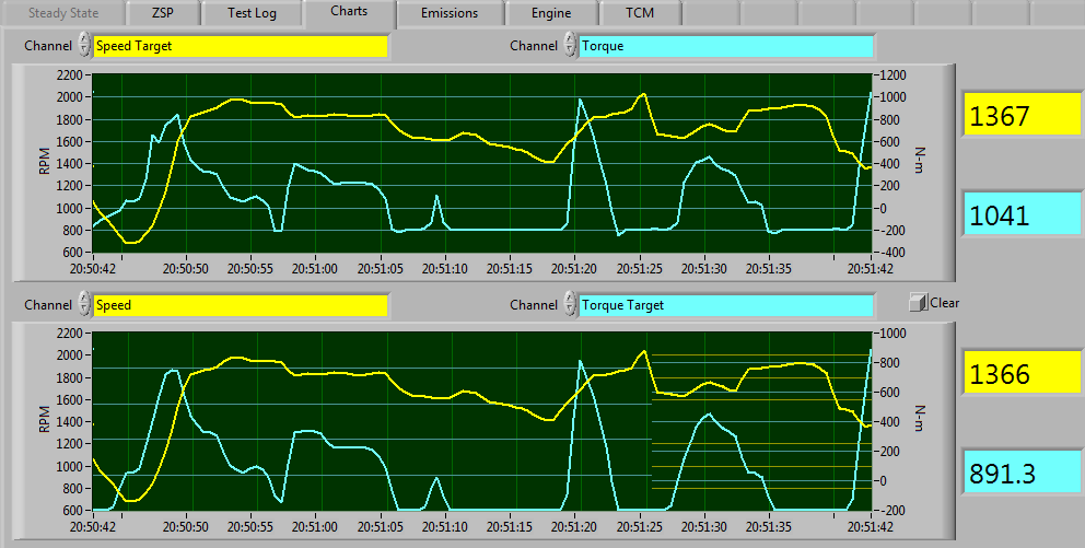

Here's another instance of chart misbehavior.
This time the average CPU usage was 4-6 %.  The issue with writing the debugging files is gone.
But I switched tabs from one of the text tabs to the charts tab at 20:51:25, so the instantaneous CPU load might be high.
 The charts are fed at 2 Hz regardless of whether their tab is showing or not.

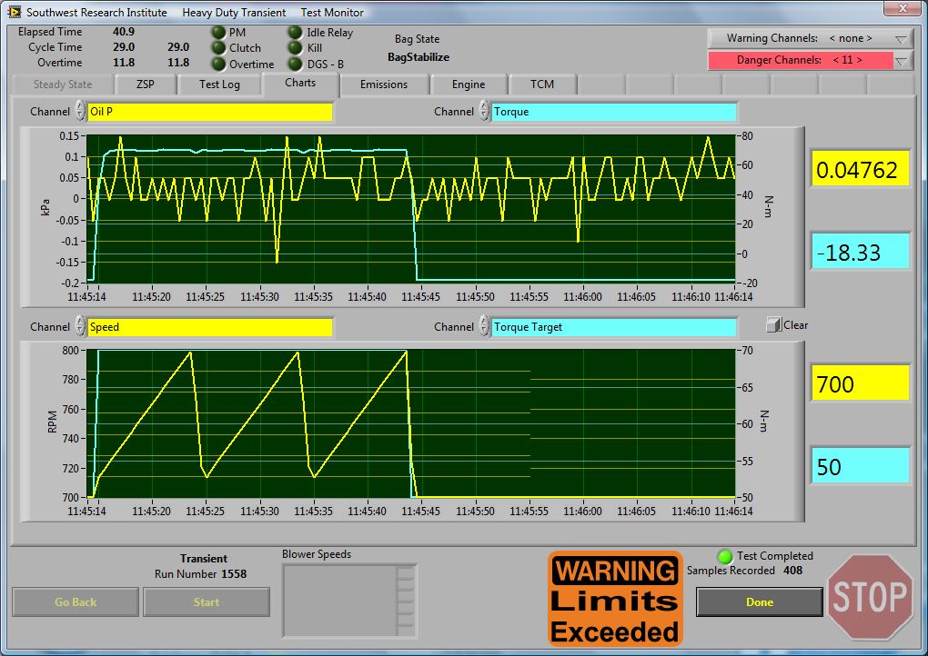

Here is another shot.  This is an actual test and right about the time the test was over, the display hiccupped.
In this case the CPU was loaded at 6-8 %, although the instantaneous load may have been much higher, since I enable some buttons, disable some buttons, and do other things when the test is over.
The chart doesn't stop when my test is over, although the program switches to a different tab when that happens.  When I switched back, it looked like this, with the messed-up Y gridlines.
At 11:45:14 the test started, 408 samples later would be  11:45:54.8, which is where the glitch starts.
