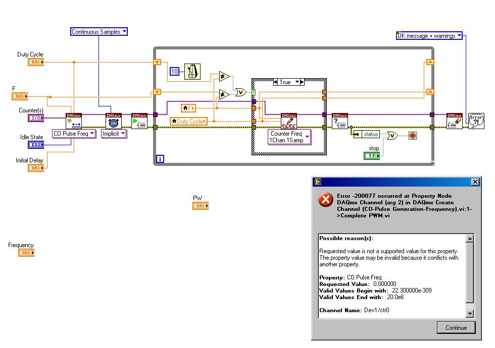

I have attempted to replace the Frequency control with another in the Complete PWM example found here:
https://knowledge.ni.com/KnowledgeArticleDetails?id=kA03q000000x1P0CAI&l=en-US
However, I get the following error message:
Possible reason(s):
Requested value is not a supported value for this property. The property value may be invalid because it conflicts with another property.
Property: CO.Pulse.Freq
Requested Value:  0.000000
Valid Values Begin with:  22.300000e-309
Valid Values End with:  20.0e6
Channel Name: Dev1/ctr0
Task Name: _unnamedTask<10>
My wiring diagram looks like this:
if I undo my change (i.e. I remove the knob frequency control and return it to the control from the example it works perfectly.  I get the waveforms to show up in the oscilloscope.
My goal is to simply use a knob control for duty cycle and frequency.  How can I achieve this?

Does that error only happen when the frequency is set to zero? If so when you replace it with a knob, set the minimum knob value to something above zero.
Message 2 of 8
(4,557 Views)
The minimum value is set to 50Hz and maximum is 300Hz.  I do it by right clicking on the knob marked "F" and going to properties.
Is there another way to set these values?

Could you save a copy for version 8.6 and I'll have a look at the VI
The file you have attached, does not have any minimum value set for the knob.
So if you just run your vi, the F confrol will be 0, and the DAQmx will complain.
The minimum input frequency has to be above 0.

Can somebody point me to either a link or PDF documents get defines exactly how to change the minimum and maximum values of the knob?
Maybe I'm doing this wrong but when I right click on knob in the front panel and goto properties, there is a section that says "Minimum" and "maximum".  When I define them to be 50 and 300 respectively I can clearly see the knob updates with different values ranging from 50 - 300.

There are two things to do.
What I think you have done by now is changing the Scale of the knob.
You also need to change what values are allowed to enter. You'll do that in the Data Entry tab in the properti dialog box of the knob.
Unclick the "Use Default Limits", set the Minimum and Maximum to the same as in your scale.
Set "Response to value outside limits" to Coerce for both Minimum and Maximum.
I hope this helps.
