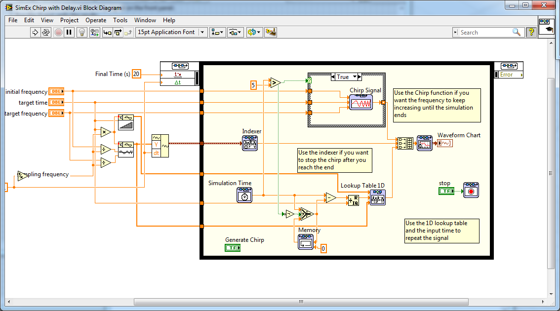

Craig,
Your solution will 'cut' the beginning of the signal and only show the signal afterwards.
To control when the chirp should start, the best option is to use the Chirp Pattern.vi ( in the Signal Generation palette) and use a Lookup table to control when to feed the time. The shipping example (in LabVIEW 2013) shows how to code using a lookup table.
C:\Program Files (x86)\National Instruments\LabVIEW 2013\examples\Control and Simulation\Simulation\Signal Generation\SimEx Chirp.vi
Then, to start from a toggled boolean, look at the example:
C:\Program Files (x86)\National Instruments\LabVIEW 2013\examples\Control and Simulation\Simulation\Signal Generation\SimEx Step.vi
and Here is the example in 2013 (in attachment):
Barp - Control, Simulation, RTT and HIL - National Instruments
(4,009 Views)
One more thing: if you don't want to repeat over and over, just remove the "Quotient and Remainder" before the Lookup table....
This example starts the sweep after 5 s. if you want to start by pressing a button, just need to wire a button the the inverter.
