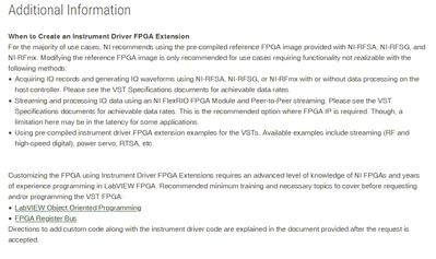

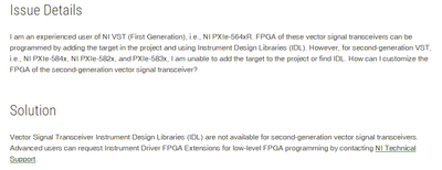

I think RIO driver is the term used when LV FPGA first came out when there were less product lines.  As above, the term is still used.  These days I recommend being more product line specific (e.g., FlexRIO, R Series, cRIO).
To load a custom bitfile into any of the 1st and 2nd gen VSTs, see https://knowledge.ni.com/KnowledgeArticleDetails?id=kA00Z000000g2pKSAQ&l=en-US.  You just need the RFSA and RFSG drivers.

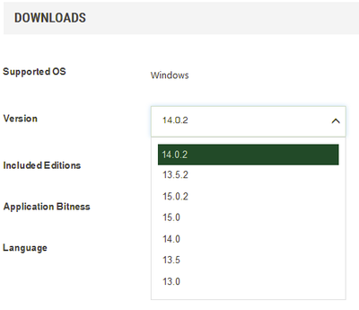

Hi again
Found the IDL download location for the now very old versions, and NI's statement about that :
https://knowledge.ni.com/KnowledgeArticleDetails?id=kA00Z000000g2pUSAQ&l=da-DK
Quote : "For the majority of use cases, NI recommends using the pre-compiled reference FPGA image provided with NI-RFSA, NI-RFSG, and NI-RFmx."
There are only downloads for these LV 2013 to 2015 compatible IDL versions :
Here :
https://www.ni.com/en/support/downloads/drivers/download.labview-instrument-design-libraries-for-vec...
