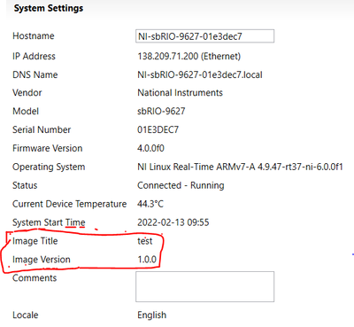

Where does the Sys Cfg API get the image Title and Version?
When using the Sys Cfg API, where does it get the image Title and Version both when setting the image, when retrieving these values?
In the case of setting it, from where in a system image file are those values retrieved and applied to the target?
I the case of reading back those values, from where on the target does the API read those values?

In case anyone has the same question, grep'd it out and it appears to be stored at:
/etc/natinst/share/scs_imagemetadata.ini
