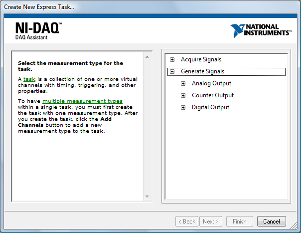

@Andy K wrote:
The DAQ assistant will only let me acquire signals not generate so I need something similar to the daq assistant but for generating signals not acquiring.
thanks
Andy
The DAQ Assistant will most certainly allow you to create an analog output task.
(2,928 Views)

my problem was that I was being lazy and had done a copy/paste of DAQ assistant 1 that was acquiring signals.
When I added the DAQ assistant 2 in the block diagram by selecting signal express>generate signals>daq assistant from the function palette I got the "create new express task" window appear where generate or acquire appears as an option which wasn't there before.
