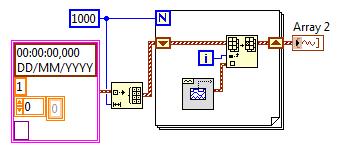

I think in this case OP is talking about replacing some elements in the array, so pre-allocating that to the maximum array size then doing a replace is the most efficient.  The example is probably simplified.
That being said OP can try something like this, which will preallocate 100 waveforms with 1000 points in each.
