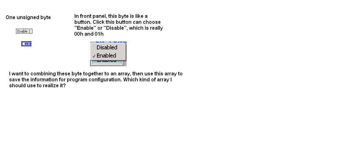

Hi, I have several unsigned byte variables, and want to build them together as an array for future use in configuration saving. Could any one tell me which kind of array I should use? Or should I use "build array"?1.PNG

Is your data multiple instances of some type of value or are you simply putting them into an array for convenience? If you are simply stuffing unrelated items into an array for convenience then don't do that. It will only serve to confuse anyone that comes along later to work on the code. Arrays should be collections of like data, not just unrelated things of the same data type. Also, if you are saving the data to a configuration file, do you want it to be human readable? Will people use and editor to make changes to the data? If so, then save your data in a meaningful way. In your case don't save 0 and 1 but rather save the value as "Enabled"/"Disabled". This is much easier for someone editing the file to understand. You can look at the examples that ship with LabVIEW for working with ini configuration files.

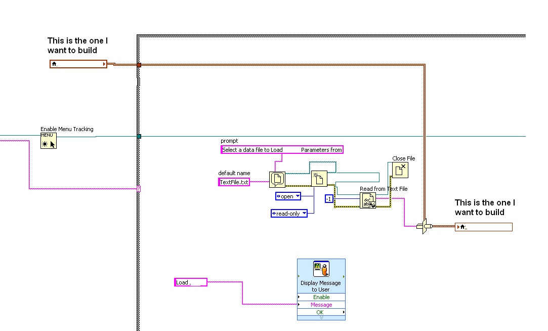

Hi Mark, thank you very much for your quick and detailed reply!And I will explain to you about my target then hope you can advise me more.
Like you see in the picture, I have a lot of items in front panel, and here I only showed one, its name is "enable". When we click on it, you can choose "ENABLE" or "DISABLE".
Currently what I have is a lot of related items (their function is independent). For example, I have three items, "enable1", "enable2" and "enable3". And all of them can be set as "ENABLE" or "DISABLE".
The final target is to put this array (or vector, or anything else you think the most suitable one) into the "save configuration file" diagram. I use the following picture as the template for "load the configuration". Could you tell me which is the best way to do? Thank you very much!

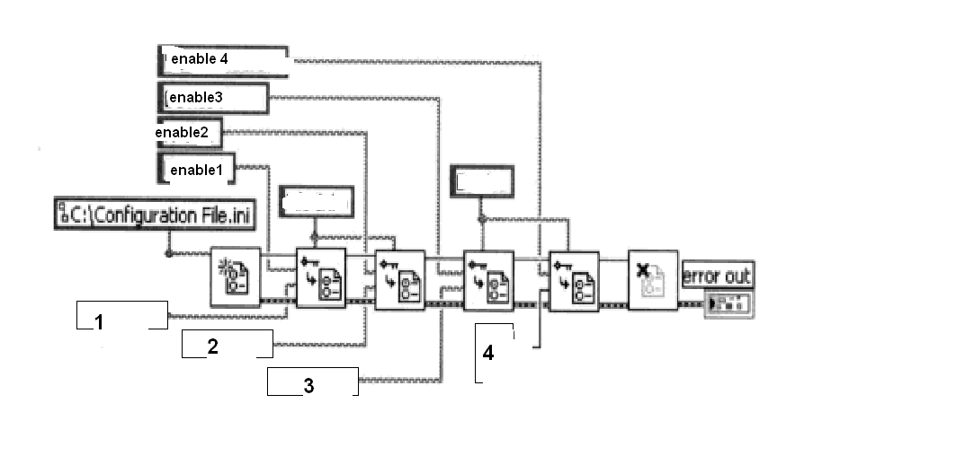

Thank you Mark, you are right, it should be better to use them individually. Since I am not familiar with configuration file programming, could you answer me some questions based on the following picture (it is a write to configuration diagram)?
If the ini file is created like this
[Application]
enable1 = Enabled
enable2 = Disabled
enable3 = Enabled
enable4 = Disabled
Stop on Error = Yes
(1) Since enable=00h, disable=01h, should I fill in the region "1", "2", "3" and "4" in the picture like "00","01", "00" and "01" for default value? If "1","2""3" and "4" are not for default value, what I suppose to put there?
(2) If I have changed the value on the panel and want to save updated configuration file, is this structure good enough?
