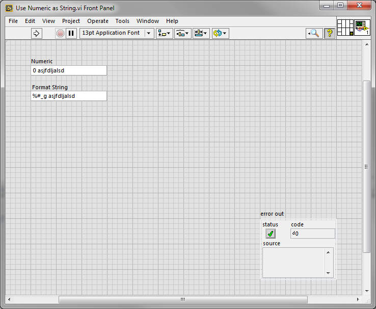

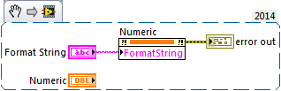

Bottom line: What is a numeric control ?
A String !
A numeric Windows object (not talking about G object) is just a text box limited to numbers.
In C language, U8 is defined as char
In LabVIEW, you can re-format a numeric control, and use it as a string.
