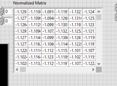

Why a normalized vector VI gives value with -1 ?

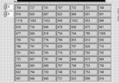

I have a 2d array pf 360x360
with a good and proper image forming
now I used this to normalize that array so it comes b/w 0 and 1 and not <0
whereas it is giving values <0
original matrix don't have any -ve values
Why do you use a matrix function when you want to use a simple InRangeAndCoerce operation???
Or do you want to calculate simple math like
y = (x - min(x))/(max(x) - min(x))
with y and x being 2D arrays?
After taking basic LabVIEW training you should have heard of polymorphism…

Yes for sure I'm trying to learn and get basic training of LabVIEW!
Being a bit new to this makes
from normalization I mean
summation of all elements of a row and divide each element with this sum
like
1 2 3 = 1+ 2 +3 =6   =>1/6 , 2/6 , 3/6
4 5 6 = 4+ 5 +6 =15   =>4/15 , 5/15 , 6/15
7 8 9
(2,304 Views)

Hi gpt,
Use an autoindexing FOR loop to iterate of the rows of your 2D array.
Inside the loop you calculate the sum of the row (ArraySum) and divide the row by that sum
Then output the scaled row values using an autoindexing tunnel to get the resulting "normalized" 2D array…
Pretty basic stuff involving loops, autoindexing, polymorphism.
