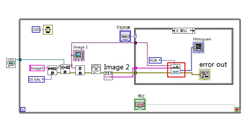

I am sorry for proposing a question which is not described in details.
My problem is that a subVI can run freely without any error.
But when this subVI is added into a case structure of a toplevel VI
it would report error when run.
Attachment is the subVI and the error reported.
Thank you!
No, that's just an image of a diagram, not a subVI.
You circled a subVI in red. Is that the function that generates the error? Who wrote it?
Can you paste th full text of the error message, it currently is truncated in the image.

the attachment image is the subVI,
The rectangle I circle in red is where the error happen.
I am confused why it could run freely itself but could not ...when it is included into another VI.

I don't have IMAQ installed, but does the icon with the "trash can" on it delete the IMAQ reference? I suspect it does and so you end up with no reference for your SubVI. If that's the case, you need to put the "delete reference" outside the loop after it terminates.
