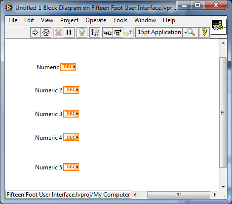

A nice new feature in 2012 is being able to select multiple terminals (or controls) and create local variables for the group.  If I drop a numeric control and then use control+click to copy it a couple times, creating a column:

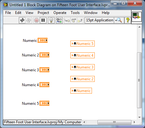

Then lasso the column and Create->Local Variable, ther resulting variables are created in the opposite order:
Direction of lasso doesn't matter (top to bottom or bottom to top).  It would be nice if the lasso option created them in the same vertical order.
(If I individually select the terminals they are created from top to bottom in the order they were selected.)

Probably based on the z-order of the controls if you select multiple items at the same time.
Try reordering the controls on the block diagram (move forward, move backward, move to front, move to back) before selecting them at one time and see if that changes the results.
Since numeric 5 was probably created after 4, which was created after 3, 5 is probably more on top in the z-order compared to 4, then compare to 3, .....
(3,275 Views)
It does appear to be driven by the z order.  Re-ordering the terminals changed the order of the local variables.  But I think it should be creating from 'back to front' instead of 'front to back'.  Having to reorder is not a practical solution.
I suppose I could get used to created controls/indicators in the 'opposite order', but shouldn't tools make life easier?  Is there a coherent design reason for the current behavior?
(3,264 Views)
Probably not. This behavior (the order of the selection list) predates this new feature by many years and when it was first implemented the specs for it probably weren't that good, since it was probably a private property. I'm guessing it's just an accident.
Incidentally, the reverse Z order thing is for each group in the selection, so if you shift-select a bunch of control and then shift-select a few others, you'll get two groups sorted by reverse Z order. I agree that it's annoying, but I don't think anything's ever been done about it. I suggest an idea exchange entry if one doesn't already exist.
