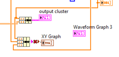

I got the same problem, the representation is double and they all have the same length of data but cannot be connected either to xy graph or waveform graph.  What could be the problem?
