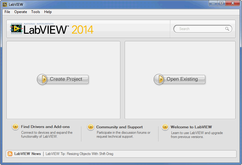

Hi Bryan24,
I can understand the confusion. Just to clarify, while the Getting Started Window does not actually say getting started anywhere on it, this window is the Getting Started Window

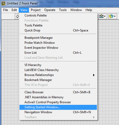

And you can launch it from within LabVIEW through the menus
The Getting Started Window is the landing page for LabVIEW when you do not have anything open, it is where you 'get started' on projects or new VIs. I can understand the confusion because there are other products that have a getting started popup for new users before the environment launches. In that case it is common to suppress that getting started help for users who no longer need the getting started guidance.

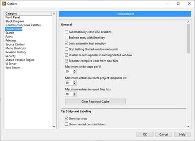

For me, it doesn't get much more intuitive than this:
I just guessed it would be under "environment".
Or did I misunderstand you?

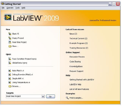

A very long time a go, it was the "Getting Started" window:
