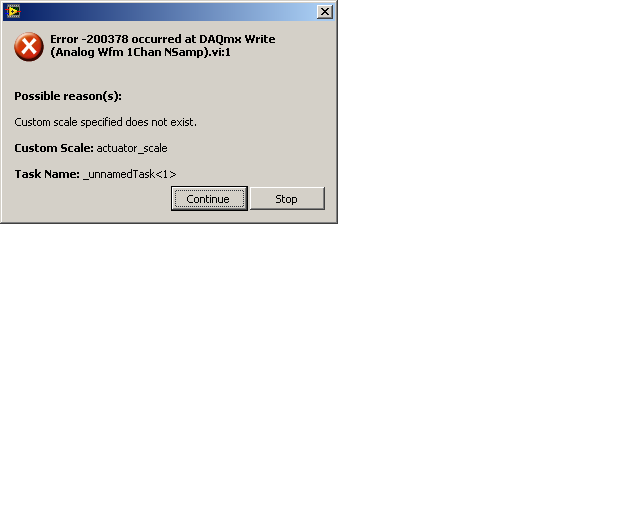

Why does opening a VI inside a project break it with regard to DAQ-MX communications?
Recently I imported a set of VI's into a Labview project (.LVPROJ file).  Now when I open and run the main VI from within the project my code that generates a signal using DAQ-MX vi's is broken (see error dialog below). Yet when I run the same VI from outside the project the VI works as expected.
Any ideas what is going on here?
(2,772 Views)
Your error could probably be fixed following the instructions @ Why Do I Get Error 200378 When Running a Stand Alone Application?

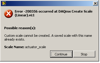

Thanks for finding that article. Following the advice on the page why do I get Error 200378, I added a custom scale to the project but then my app fails to run with the error -200356 cannot create scale because my VI creates the scale programmtically using "DAQmx Create Scale.vi". So, I don't think that helps.
(2,744 Views)
Accepted by topic author AzimJ
you need to modify the existing scale and overwrite it since you cannot create a scale with the same name
Here is a link to an example that shows how to open an existing scale and modify it:
Developer Zone Example: Change DAQmx scales in LabVIEW and save the changed scales to MAX
Please let me know if it works
