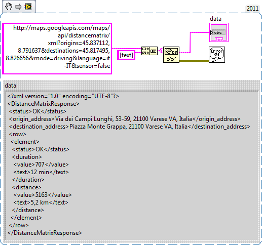

I trying to use the HTTP get function to get the XML file is returned from the Google MAPS api distance-matrix. I receive the right answer if I insert the url directly on the browser but using the HTTP get function it returns the error 63, why?
This his is my code (the VI is developed on LV2011).

I guess, the GET VI intended for using with LabVIEW Web Service, not for obtaining pages from Internet.
Use more simplest way:
Andrey.
(3,456 Views)
Thank you very much for the trick. It seems to work very good!
