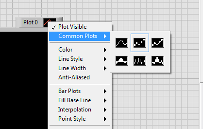

I want my output to be visible only at integral value i.e. For n=1,2,3..the output should be 1 or 0(y axis) as per condition but in between 0 to 1 and 1 to 2..and so on...there must be no visible output at all.
Message 29 of 38
(1,115 Views)
your are only a few Right-Clicks away from what you want.  (just a different way of showing the points- without the lines)
