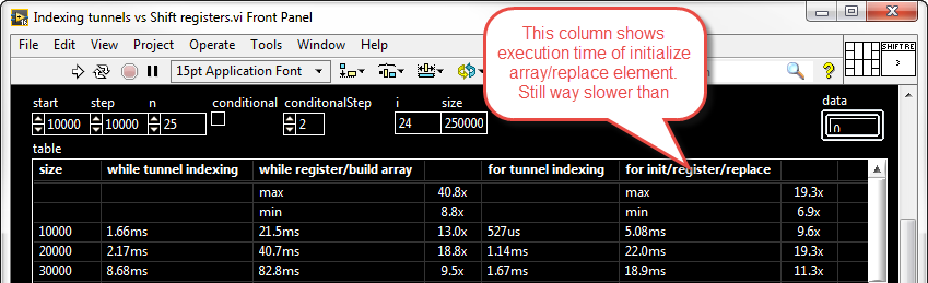

Why is indexing conditional tunnel 3x faster than shift registers
Why is indexing conditional tunnel 3x faster than shift registers?
It must have something to do with somekind of optimization code managing the array allocation, but why can't it do it in both cases?
Run attached example.

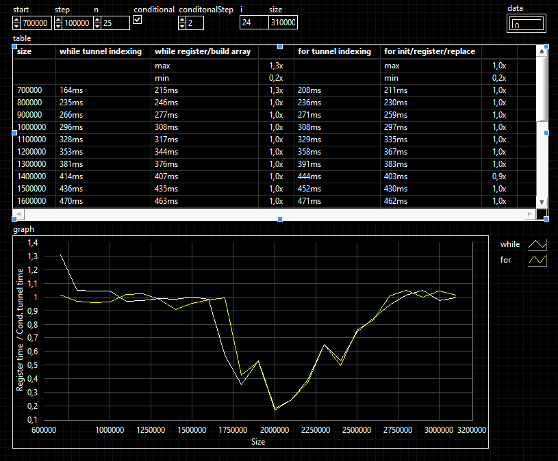

jacemdom - you got parts of the shift-register based solution wrong (and had only put it into the for-loop version). I would also turn off debugging when doing such tests. Attached is a revised version (backsaved to LV2012).
Preallocating the array at its maximum size, then resizing it to the resulting number of elements, makes the shift-register based solution more comparable to the auto-indexing function. With large arrays and the conditional factor low, it is even faster (but uses more memory than needed, which can also partially explain why the conditional has an edge, but not fully...to really understand why the auto-indexing function mostly wins requires more under the hood knowledge than I have...). Here is one example test:
As you can see I have turned on condtional (that's what we are interested in here anyway), and have ramped up the array size. This is also with the corrected code of course.
The conditional auto-indexing  has an algorithm that resizes the array "intelligently" (that is, it got such in its second revision, at first it too was a "stupid" build array solution), typically with increasing step sizes (I'm not sure of the exact implementation, but one approach is to double the size every time it needs a resize, so when the array hits a limit at 4 elements it will go to 8, at 8 it will jump to 16 etc...perhaps with a max (if knowable) as a cap on the resizing. This way even very large arrays will not be rezied that many times, and if the resulting array turns out to not be that large the algorithm will not have wasted much memory (at worst by a factor of 2). We could of course implement a similar approach with shift registers (to save some memory when the result is less than half of the max), but not as efficiently as the native LabVIEW code.
