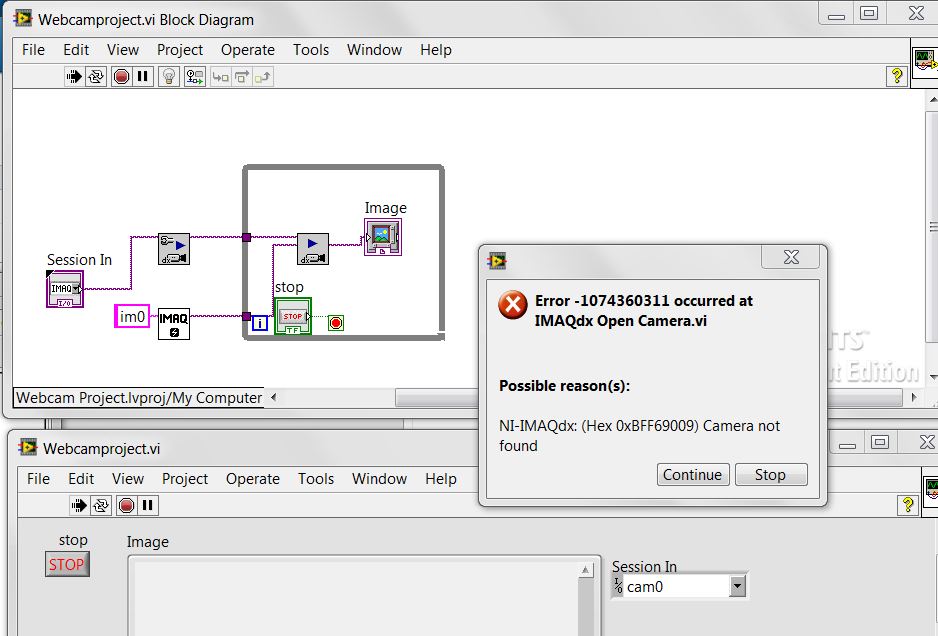

I plugged my Logitech camera into the myRIO USB port. In both cases, LabView failed to recognize my Logitech camera. However, in both cases, it was able to use the integrated Webcam in my laptop to acquire images. When I disabled the integrated camera, it did not find any camera.
Here is a screenshot of the error when I disabled the integrated camera:

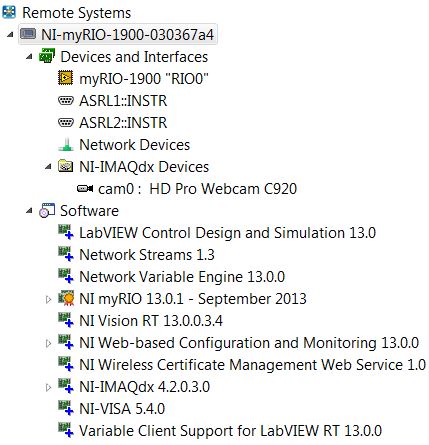

However, when I look at the MAX, the Logitech camera appears and is able to acquire images:

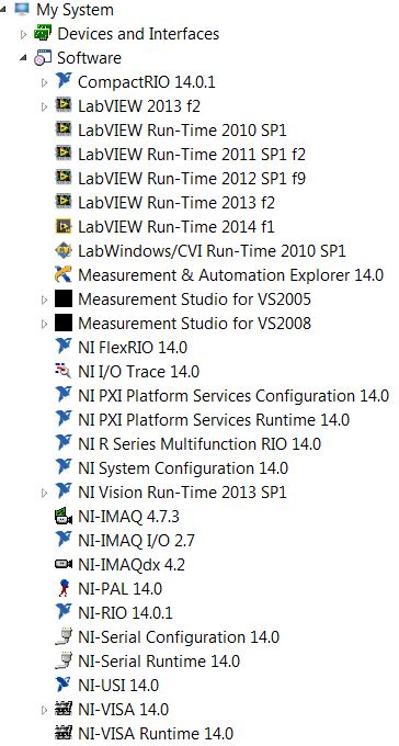

Hooovahh, I am sorry but I don't know what you mean. Where can I obtain the source code so that I can send it to you?
I don't know if this is what you need, but here are two pictures of the software that I am running. The first is the software on my computer, and the second is of the myRIO. Perhaps there are compatibility issues?
Thank you for your time and help,
David

I did find a solution to my problem.
I was trying to follow the code used in this youtube video:
https://www.youtube.com/watch?v=Fup-ro7qWxk
But it didn't work.
So I decided to download NI's code directly instead. You can link to it from their project essentials guide:
http://www.ni.com/gate/gb/GB_ACADNIRIOGUIDE/US
As it turns out, I think you need an IMAQdx Open Camera.vi block before the IMAQdx Snap.vi block. I have no idea how the guy in the video got his code to work.
