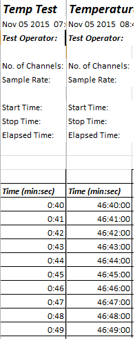

My program works fine, but my customer requested that some of the timestamps be in the minute:second format. I've used the time format string %M:%S to save my data to an Excel file. On my computer, it works fine ... but when I created an executable and installed it onto the customer's computer the minute: second format had additional zeros following. For example: 46 minutes, 45 seconds is displayed as 46:45 on my computer ... but is displayed as 46:45:00 with the executable installed. Also, when I select the cell .. it shows 10:45:00 PM I've attached my code ... I know that it's slightly messy, but could you please focus on the time format strings only. The strings are in the main vi titled, "Temperature_Measurement_rev2.vi". I've also attached a good and bad file. Thanks

My problem is down farther ... in the "Time (min:sec)" column. Also, when you click on one of the individual cells ... it's no longer in the minute:second format from LabVIEW.

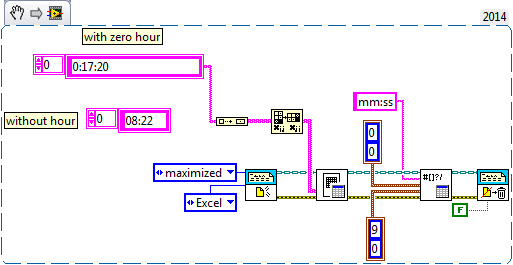

Building on Bob's response, but referring to my block diagram:
You could use the "%M:%S" formatted timestamp that you currently use in LabVIEW, and set the Excel display string to "hh:mm". You would be "lying" in that you are actually displaying minutes and seconds, not hours and minutes, but it would format it correctly. Though if your customer highlights the cell it would show "mins:secs:00" which might confuse them.

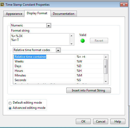

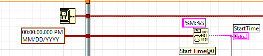

That would be your problem!  the implied %<>c on the format specifier for the relative timestamp constant uses the local machine time. a %<>T might help or use an absolute time format
