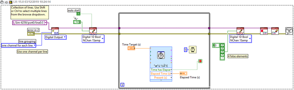

Here's a copy of your V3, with the suggested changes by others above implemented.
The key point is that after waiting (using the Elapsed Time node) I set the values all to False again (to disconnect the relay).
Note that since you have "Auto-start" set to True, you don't need to call Start anywhere. Also, you previously had this after the loop, which wouldn't have been what you wanted (you'd have waited before starting).
You only need to write the values once (each) - the "On" choices before waiting (the loop) and the Off (4*False) after, so neither should be inside the loop.
I also added a very short Wait inside the loop to prevent using 100% CPU.
I replaced the 4*Create Virtual Channel with a single call, and passed all 4 lines into it together. Note that the effect is the same (but much less space is used).
