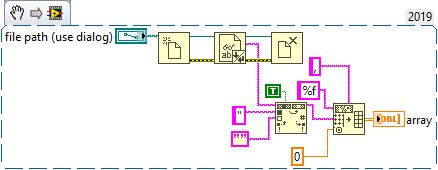

Here's a snippet of one quick way. There may be a less Rube Goldberg method - I just didn't take the time to think it through.

In any event the example that I gave will work for both files. If there are quotation marks then it will remove them. If there are no quotation marks then it will move on.
