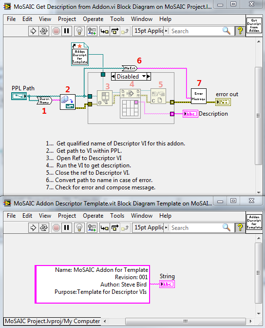

The VI that is executed is shown in the bottom part of this screen shot.
If I disable the part that runs the VI (as shown), then the busy cursor does NOT appear.

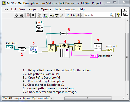

Here is the whole sequence.

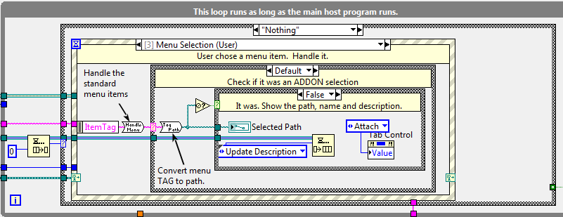

PIC 1: I respond to a MENU SELECTION by handling the "standard" events first (switching windows, CutCopyPaste, etc).  If it's handled there, the result is blank, otherwise the tag is unchanged.
   If it's a "standard" event, none of this BUSY stuff happens.

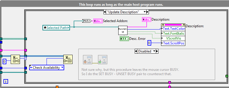

  Otherwise, I check if it's from the ADDON menu by attempting to convert the menu tag into a path. If the path is NOT blank, it's an addon.  I display the path and trigger an UPDATE DESCRIPTION action.  I also switch tabs.  I've disabled that switch tabs, and nothing changes.
PIC 2: I take the selected path and update the UI from it.  (If there is an error, I use the error text and turn the text plain red, if no error, I use the text from the VI and show it in black italics).
  I can disable the CHECK AVAILABILITY action, and nothing changes.

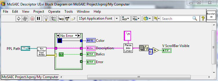

PIC 3: shows details of the UI handling.
PIC 4: Here, given a PPL path, I obtain the path of a particular VI within it, open a ref at that path, execute that VI, and close the ref.  I check for errors and compose a message if so.  As I mentioned earlier, I can disable that execute sequence and this doesn't happen.

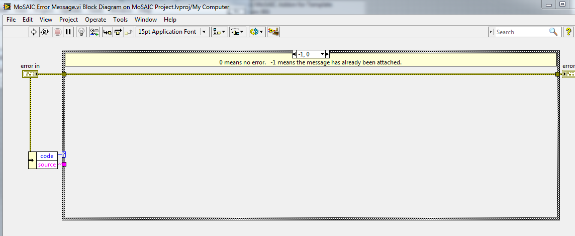

PIC 5:  The error checking does nothing if there is no error.
