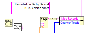

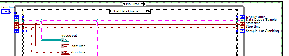

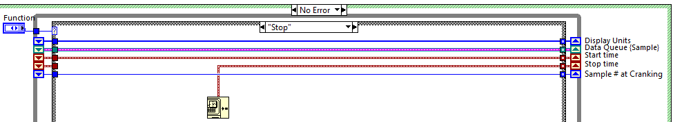

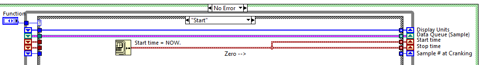

Like I said, I'm recording time A with a GET DATE/TIME IN SECONDS function with unwired inputs:
Like I said, I'm recording time B with a GET DATE/TIME IN SECONDS function with unwired inputs: Time2.PNG
Like I said, I'm recording time C with a GET DATE/TIME IN SECONDS function with unwired inputs:

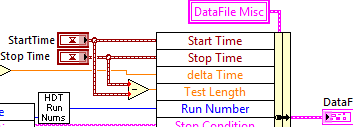

When it's time to assemble the data file, the A and B values are fed out as timestamps...
... and put into the file as timestamps:

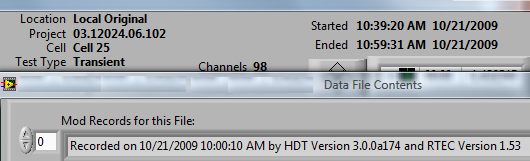

How do you see the difference? Is this a string indicator or a Timestamp indicator?
A and B are displayed in Timestamp indicators:
The only formatting change is that I removed the <return> so that they display on a single line:
Item C is displayed in a string indicator (actually an array of them) in the above pic.
As you can see in that last pic, the test ended at 10:59:31, but the "Recorded on" date is almost an hour earlier.
What you CAN'T see from these pictures is whether or not I CALL the pictured functions at the time I am claiming; you'll just have to take my word for that.
The fact that it's (almost) exactly an hour difference in all the files with no post-test CAL operations indicates that it's not that I'm calling the "Recorded ON" function (point C) at 10:00:10, waiting for 40 minutes and then starting the test.
