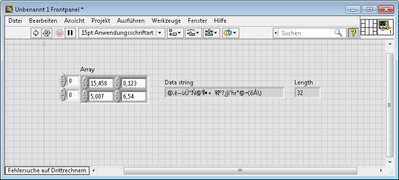

Why wont typecast allow me to concatenate?
As in the above snippet, I am not allowed to contatenate the output from a type cast. Why?
I was hoping to end up with a string of length (ROWS*COLS)*64/8, because each element is a 64-bit double, and every 8 bits will be interpreted as an ASCII character. Or am I understanding something wrong?

Hi doug,
because you cannot concatenate strings at all using loop tunnels…
Simple fix (using ConcatenateStrings):
(First of all, you don't need the inner loop. You can cast a 1D DBL array directly.)
Second, all you probably need is a flatten to string without size information prepended, right?

My problem is that I want to convert the 2D Array to an ASCII string.
So for the following 2-by-2 array of doubles:
IN DECIMAL
15.458 0.123
5.007 6.540
IN BINARY
0100000000101110111010100111111011111001110110110010001011010001 0011111110111111011111001110110110010001011010000111001010110000
0100000000010100000001110010101100000010000011000100100110111010 0100000000011010001010001111010111000010100011110101110000101001
concatenated column by column, row by row:
0100000000101110111010100111111011111001110110110010001011010001001111111011111101111100111011011001000101101000011100101011000001000000000101000000011100101011000000100000110001001001101110100100000000011010001010001111010111000010100011110101110000101001
interpreted as ASCII string:
@.ê~ùÛ"Ñ?¿|í‘hr°@+ Iº@(õ\)
which has length 32, as expected.

(posting by phone, cannot test).
My code should do that. Have you tried?
If you want to do by columns, transpose the 2D array first.

Works, however I am not getting the same output as expected (done on this website) ... I'll trust LabVIEW on that.
Many thanks!

try right click on the string indicator and choose "Hex Display" perhaps this more helpful to compare.

Hi doug,
that website only accepts ASCII text, but no DBL float numbers…

I used this website to convert my doubles to binary, followed by this website to convert the concatenated binary to ASCII.
